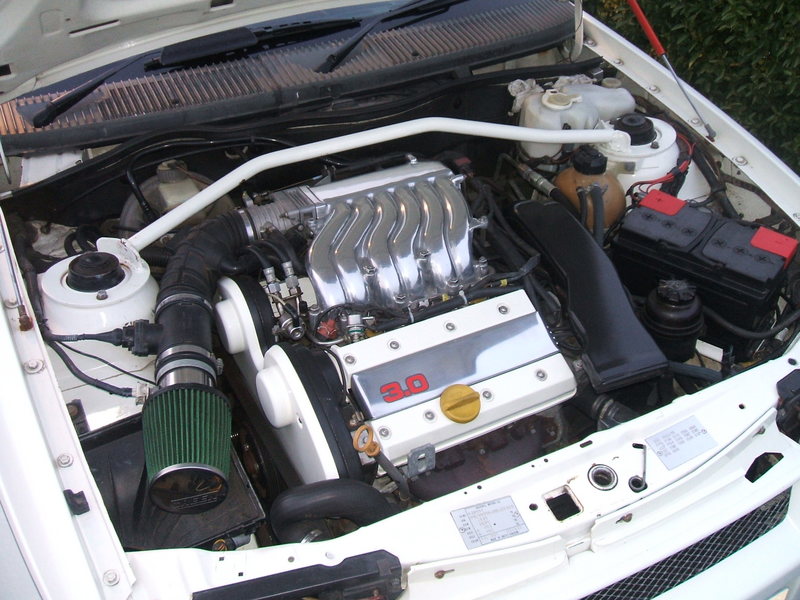

    Si Marc tu dame ideas xDDD.
    Bueno ahi va
    Car
    1988 Vauxhall Astra Originally a GTE 8v, Polar White
    Engine
    2962cc 30XE V6 24valve conversion,3.0ltr Courtenay Hi-torque cams,
    Courtenay re-programmed ECU, 2.5" dia Jetex S.S. Exhaust system
    4 bar fuel pressure regulator, Courtenay Enlarged throttle body
    Traction control flap removed, Green cone filter
    Gearbox

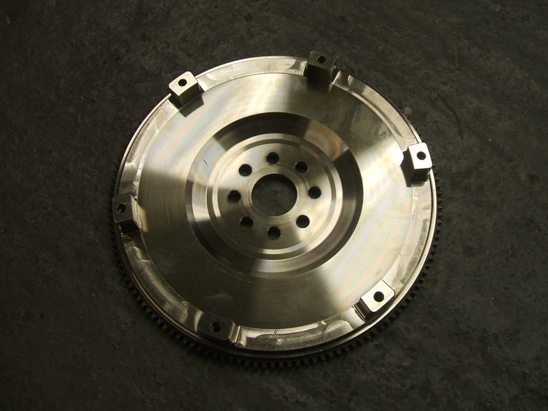

    Standard F20 5 Speed Manual, Courtenay Billet XE flywheel
    Uprated Courtney H/D Clutch, ATB LSD, (Planned equal length shafts)
    Brakes
    Front - Redrilled GM 288mm V6 Vented discs and Calipers
    Rear - GM 200mm drums.
    Suspension / Steering
    Front - Independent Mac pherson strut,
    Up rated V6 springs and Blisten dampers with anti-roll bar & strut brace.
    Rear - Semi-independent trailing link,
    Up rated springs and Blisten dampers with anti-roll bar.
    Polyurethane Bushes through out.
    PAS system installed from 16v due to weight over front wheels.

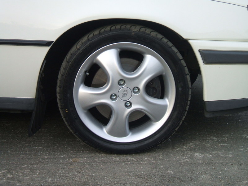

    Wheels & Tyres
    6.5 x 16” Irmscher Softstars with 195x45x16 Falcons
    Exterior
    Standard (body work coming soon)
    Interior
    Standard beige/rainbow Recaro trim with Early Door Cards, Black Dash, Snap-off steering wheel with OMP steering wheel.
    I.C.E
    Kenwood 9070R Mask CD head unit, JBL GTO 4” replacement dash speakers, JVC 6x9's on back shelf
    Performance
    235.5bhp @ 5722rpm, 224.2lb/ft @ 4566rpm
    Standing 1/4 13.907 @ 100.66mph
